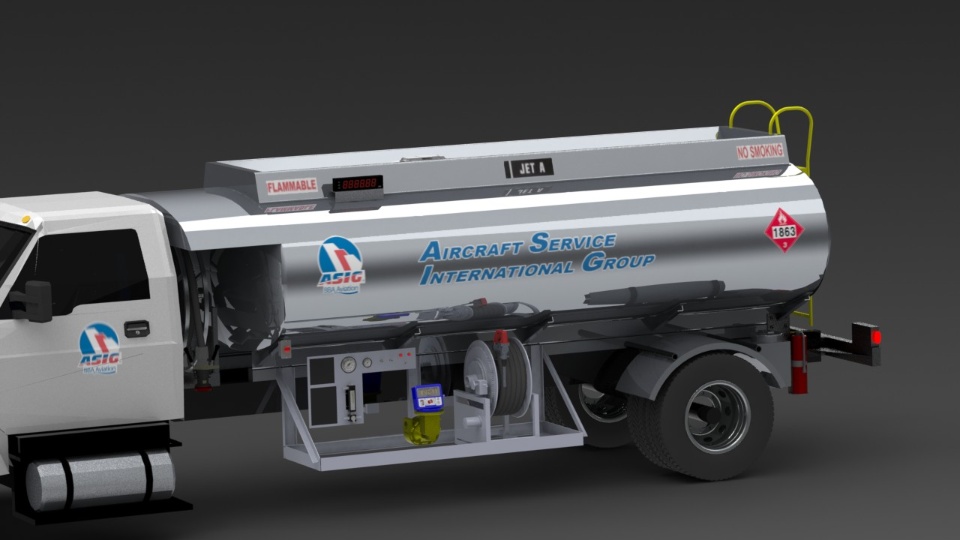

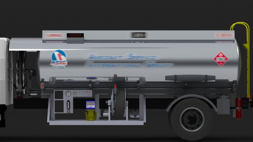

I'm having a problem with the decals showing up fuzzy in the final renders of an assembly. Attached is a couple pictures so that you can see what I mean. In the actual part files the decals come out crisp and clean but when all put together they get fuzzy.

7: Straight side renders make decals look like they have motion blur.
Doesn't make sense to me that it would be crisp in the part drawing and not the same in assembly. Also why some decals distort and some don't.
