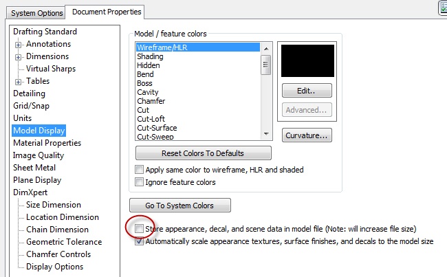

There is a Part document option to either embed the decal image into the Part model, or leave the image external to the Part model, as shown below.

Our preference is to embed the images into the Part model, because everyone doesn't have access to a common shared location to store these images external.  However, most of our company views our Drawing using eDrawings.  So, if the Decals are embedded, people viewing the Drawing with eDrawings don't see the Decal image.  But if the decals are left external, people working on them in SolidWorks that don't have access to the Decal image location, does not see the images.  There is no way to satisfy both scenarios!
My opinion is that you should not require access to any Decal image location, if the image is embedded into the Part, period.
