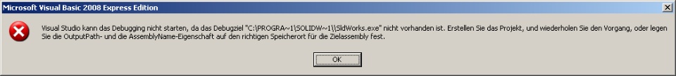

I write a addin for solidworks and did debuggin without problems.Then i put my code on my USB stick (whole project) and transfert itto an other PC. I launcht the project and tried to debugg again,but then i get an error as shown in the attached image. (sorryerror is in german i hope you know what error i mean)
error says that debugging place is not found and then the path ofsolidworks. I think the Problem is that solidworks is installed inan other path on this machine. Can somebody tell me where i have tochange the solidworks path in my Visual studio Project? In my codei doesn't use the solidworks path but i think the path is somewherein the code which was created when i use the addin Template.

In the project properties, navigate to the Debug tab and set thepath for theStart Action-Start external program to the path toSLDWORKS.exe on the new machine.
I changed this option to the right path and now it works.
