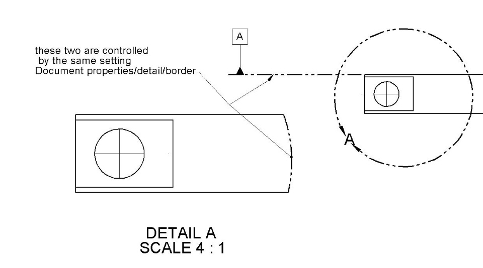

Datum GDT extension lines follow Detail Border Linetype
We upgraded from 2007 to 2009 last week.
One odditie some users found was that our datums and gdt now have athick, phantom line.
Going thru the document properties, I realize the way thesedifferent linetypes are handled are different. It must have broughtour thick detail circle thru from 07
Has anyone else experienced this or now of anyway to fix?
I am nowhere near up to date on the standards but would always makethe detail circles thicker - now I have to sacrifice one of them.
I tried loading all the predefined standards ANSI, ISO,etc. but sawno difference.
I already see I have to make my own drafting standards file so wecan tweak various decimal place displays, etc.SolidworksDrawings And Detailing

Have you tried Options-Document Properties-Line Font?
I can set Detail Circle & Border to Thick and GD&Tdimensions and datums are appearing thin and solid. Could be a 2009issue but 2008 sp5 is working as intended.
SF
SF 2008-12-16
yeah it is definitely a 2009 issue( although it might be adocument template issue) and the only work around I have found sofar is not to print.I have found that if you save a pdf, directly instead of printingit, everything comes out alright but a lot of the older designerswant to be able to print.

I am told by my var that, like it or lump it, next servicepack is the fix. I hope this is soon. datums and detail cricles areused all of the time.
SF
SF 2008-12-16
I guess I threw the towel in on this one and made the linethin/solid for the sake of the GDT.
Since they both change when going to doc properties/detail/border -figure it is locked in for now. I hope they do fix in the next sp.I am chasing down some other problems higher on my list than thisunfortunately. (ie pdm lockups on check in...)
I would love to know how to make the spacing around the letterbigger on the detail circle - anyone know how to do this? (see myscreen cap from the first post). We set the detail text to 1.5times the main text.
