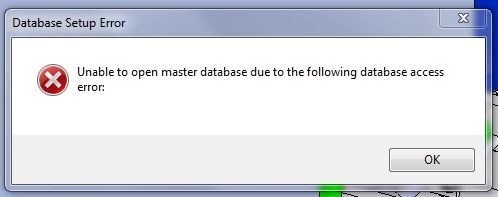

I came into work today after being off for the holidays to find a new 64bit computer on my desk. I was excited until I launched SW 2011(x64) and opened an assembly file. The error message below popped up several times while the file was loading.

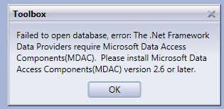

I then went to Tools/options to makes sure everything was pointing to the right direction for Toolbox. When I clicked on Hole Wizard/Toolbox the above message popped up again. The Hole Wizard and Toolbox folder is listing the proper directory on the network for our Toolbox. When I click on the configure button below the Hole Wizard/Toolbox folder, I get the error message below.

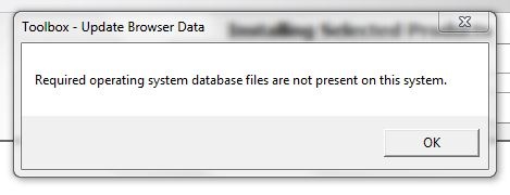

So I did a Google search for the MDAC 2.6 or later version and downloaded it and I still get the error message. So I uninstalled and then reinstalled SW2011 (x64) and during the install I got this error message.
So my question is how do I find out what "required operating system database files are not present on this system"? And then how do I install them?

TN 2012-01-11 Best Answer
After trying several things (we even tryed another new computer), I continued to get the same error messages. So there were two other new computers that we put into service at about the same time as my computer and both of those were running SW without any problems. So we looked at the differences between the two "working" computers and mine and it basically came down to my computer having two programs on it that the other computers did not have. We uninstalled both of those programs and then uninstalled/reinstalled SW. It looks like there was a program (I'm assuming 32 bit) called EasySolve that was interfering with SolidWorks. After that program was removed, I'm happy to report that SW now works fine!
