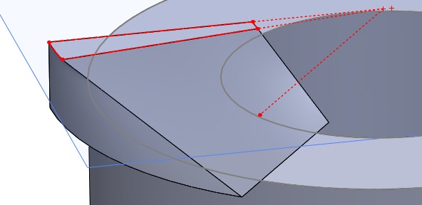

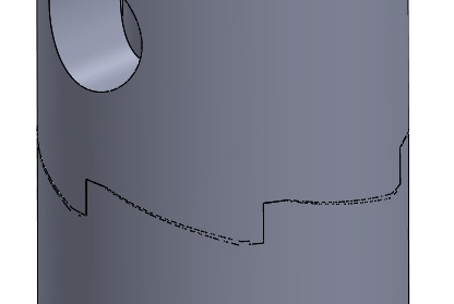

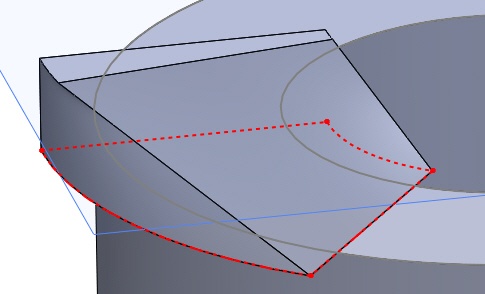

I am trying to create a cylindrical ratchet and can't figure out where to place guides to help with the loft. Below, I show with a wider foot print than the cylinder because I couldn't get guides to work, so I over extended and trimmed.
Showing top profile
Showing bottom profile
After trim
Not a good transition between two units because guides were not used.
Can anyone help?

If all you are wanting to do is match visually, you could complete the ratchets on one half, use them to cut the other half.  Cut with solid body, of offset a surface of zero distance, and cut with the surface.
JM
JM 2015-07-30
I suspect you should be using a Helical curve.
JS
JS 2015-07-30
I would probably sweep with a helical curve and then cut away the flat side.

Thanks all so far.
The helical sweep and cut extrude work good, but when I perform a circular pattern it cops all units off. I have tried a couple ways to trim the tail but all get messed up after there circular pattern.

Hi Don - I would create the ratchet bump as a Boss and don't merge it - keep it as a separate body.  Then pattern the Body (not the feature) and then combine all the bodies.

Hi Don,
Try extending the tooth of the ratchet slightly into the cylinder. The reason it may not be patterning is because of a zero thickness error.

That did the trick. Thanks everyone for all the help - I couldn't have figured it out without you.
