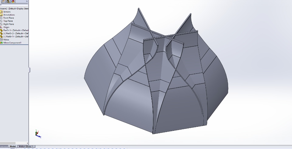

i need to make a 8 sided dome and 4 sides are diffrent than the other 4 there out of sheet metal so i go to this step with the parts in an assembly and i want to make a cut based on the intersction points so they have a mitor cut that matches up. any sugestions?

I think the easiest method might be to model all as trimmed surface bodies in a single part file, Thicken and convert to sheet metal and push out the individual parts.
It looks like a surface solution has already been suggested.
https://forum.solidworks.com/thread/72867?tstart=0
Do you know how to trim surfaces?
The fastest solution will be for you to attach your assembly here.
