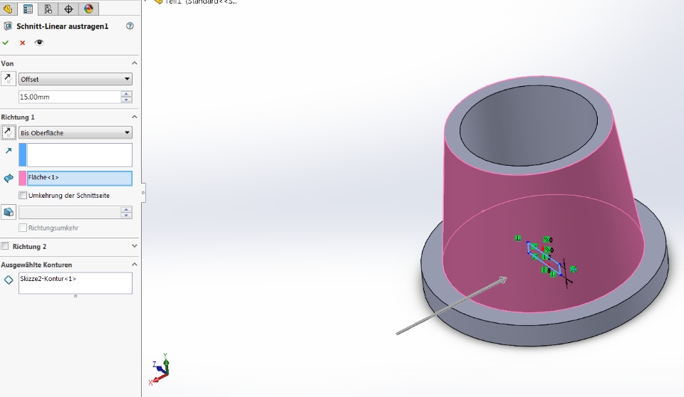

I created this simplified part to demonstrate my problem to you:
I want to create a cut until surface. This is not a problam when I do it to one side.
The problem is, I can only add the cut on one side but not on the other where I want it. (I don't want to mirror it, I just need it on the other side).
Before posting this thread, I solved the problem by creating a rotated surface. I wanted to post this anyways as a bug report, if it is a bug.

Not a bug. It is a local problem as I recreated your situation and have no problem cutting either way by selecting the Reverse Direction arrows.

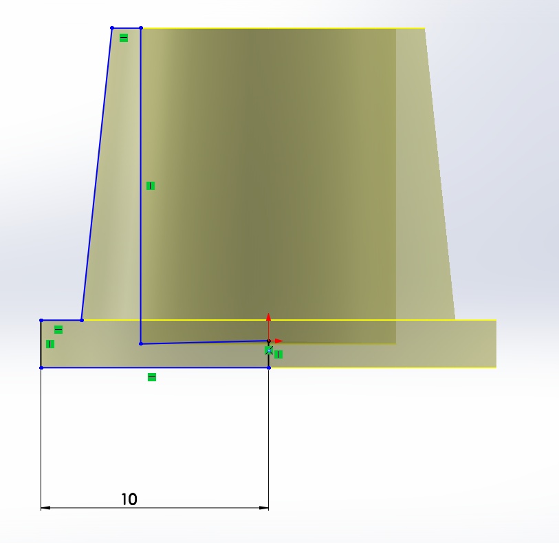

Thanks again. Now, I see that I forgot to mention that I want to cut from the outside to the inside, leading to a cut like this:
I'm sorry for not mentioning this.

Make a plane tangent to the flange Outside Diameter and cut up to surface.

I did. Again, on the one side it worked, on the other it did not. Error Message: The endface can't end the linear extrusion.

I see what you are getting at Raphael. It looks like using your method it will only cut on one side. If I try the other side I get the same message as you. What I did is to make another plane with zero offset to front or right plane and sketched on that for my cut. Then I was able to flip the side to cut by Fliping normal. That way I could cut either side. Does seem to be a bug.

I made 2 reference planes and made the first cut. I them converted the sketch on the second plane and made the same cut tike this...

Yes, flipping the normal did do the trick. This also works when using two reference planes and flipping the normal of the one that is not working. Thanks for the help guys
