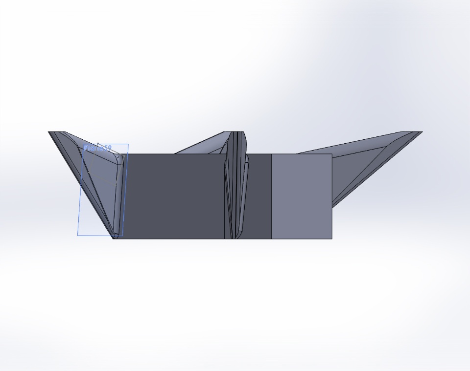

I'm stuck for 4 houres to find a way cutting through a surface of a shell and propabely keep the cutted-out parts (make a new part for this cutted-out cover)
I would like to cut sketch99 through the surface of the shell only (not cut through inside parts)
i have tried with extruded cut, but maybe this is the wrong way?

Andy I could picture as what is the final need. Can you put a screen shot highlighting the area you need.

Use the "CORE" command from the Mold Tool toolbar.

Please take a look at the attached file containing a normal cut for splitting the original body.

Is this what you want?
