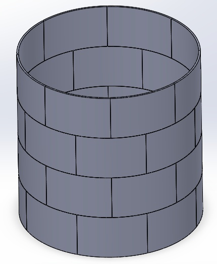

I need to model a container which is an assembly of some metal sheets. But I was asked if it was possible to do it as a full model, and then cut it, so I can use the same sketch as a reference to the welding. This would prevent me from having to selecting every single weldment individually.
I tried to use the Divide function, but I need to use surfaces and select them all. This is not helpful, because I need to select every single one of them either way. And it generates Body01 to something like Body50, which is a lot.
Using the Split Line function, I managed to do it in one go, but then I can't even weld, as they are not really separate bodies.
And there's one more thing working against this. The container is in a circle shape, and a Metal Sheet can't be defined as a circle. It need to be an arc with 359.99°. But then I can't weld it...
Please, help me.
I'm including a screenshot of the container, as an assembly, so you can see what I'm trying to do.
EDIT.: Anyway, the real problem is, can I do it? Is it possible to use a sketch as an weldment reference?
Even when I try to do it on simple extrusion it doesn't work.

have you tried doing sweeps for the circular welds? and make extrusions between the sweeps for the verticals? if it allws you to do this could do it in like 6 features or less
SF
SF 2013-09-19
By "doing sweeps" for the circular welds, did you mean to make the welds as features just like a normal object?
Or there's a way to do a sweep for the weld? If so, I don't know how, can you help me with that?
When I try to do a weld using the "Weld Bead" feature, it's not possible to select more then 2 bodies at once (so there would be welding between all of them), you can only select 2 each time and then create a "New Weld Path". The "Smart Weld Selection Tool" is just the same thing, as I still need to select them one by one, but faster.

yes sorry didnt see your reply but thats what i was implying. all you have to do is make a secion view that intersects the object your trying to make the sweep on make a sketch on that plane and do it to the outline of the gap between the objects. Next just make a plane that intersects that sketch and draw a circle or whatever shape needed and sweep with merge bodies (then give the sweep a welded apperance if youd like). it "technically" isnt a weld feature but can be used as one for those wierd areas where the fillet and beads will not work.

Thanks, this might do the trick
With one sketch, it's possible to "weld" every horizontal line.
But it still wont work with those vertical lines. I could use some circular patterns, but there's no point to it, though.
I'll mark your answer as correct so other people can see, but I gave up on this. I'm doing it like Deepak said, ignore it and then put a weld symbol on the drawing.
Again, thank you.
