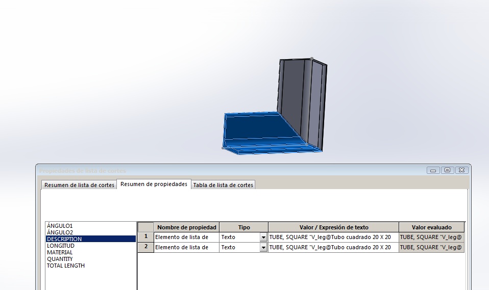

I have problems with my cut lists.
The property "description" only gets updated if I use a default profile (e.g.: iso -> square tube -> 20x20x2)
When I use a customed profile the "description" remains the last one for the last default profile that has been used.
And the cut list for the drawing appears incorrectly.
Does anybody know how to fix it, besides changing "description" property manually for each element?

Edit and fix the description property in the weldment profile. I'm sure that is broken there.

If you have quotation marks (") in your Description it will cause that error.  I've seen that error when they weren't used, but it's one thing to check.

Thank you, I think it have to do with the fact that "description" does not appear as it should, but it doesn't have to do with updating the name of the profile (I mean, for round tube it still appear, for example, tube square 20x20x2).

Check and update description in File Properties
