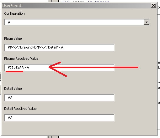

I have a macro that gets properties of configurations with a combo box. Half of it works very well except I can't get the resolved value of properties getting other properties with \\\$PRP.
I'm on SW2009 SP5 so I can't use get4.
Also, I was able to get it to work with configuration.show but I'm afraid that it would make complicated parts take a while to process.

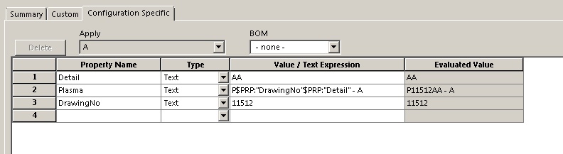

In the attached files i have 3 properties. Plasma combines DrawingNo with Detail.
But in my macro's userform the textbox should switch from P11512AA-A to P11512BB-B.
Please take a look at my code and help me.
I attached the part and macro files. Run the macro "Main".

   Set SWcustPropManager = SWdocument.Extension.CustomPropertyManager(UserForm1.ComboBox1.Text)
    value = SWcustPropManager.Get3("Plasma", False, ValOut1, ReolvedValOut1)
    UserForm1.TextBox1valout.Text = ValOut1
    UserForm1.TextBox1resolved.Text = ReolvedValOut1
    value = SWcustPropManager.Get3("Detail", False, ValOut2, ReolvedValOut2)
    UserForm1.TextBox2valout.Text = ValOut2
    UserForm1.TextBox2resolved.Text = ReolvedValOut2
