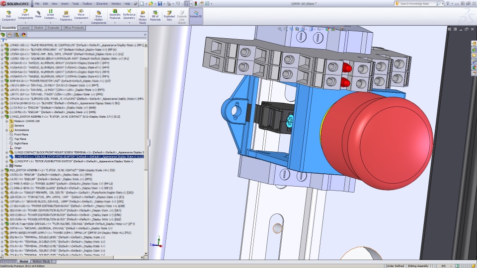

I'm having a problem with Component References. If I tag a part with a Component Reference, it shows up in the drawing balloon correctly.
If I try to tag a sub-assembly, at the sub-assembly level, it doesn't show up correctly.
As per attached images, if I tag the switch assembly (the complete 3 part sub-assembly) nothing comes through to  the drawing. If I tag the adapter part of the sub-assembly, then that tag does show in the drawing.
I have searched and seen a comment that Component References don't work with assemblies but i don't that completely true.
Does anyone have any guidance?

first off - we don't use tags, or ballons, so take this with a grain of salt.
in both of your drawing images, the balloon seems to be attached to the same component. generally to get a ballon to attach to (and read properties from) a sub-assembly, you need to attach it to a feature at the sub-assembly level - I usually see people post about using the origin of the sub-assembly.

many thanks. i'll have to look into attaching the balloon to the origin of the sub-assembly.
I have found one "resolution".
If I tag the sub-assembly with the correct component reference then the bill of materials shows the correct component reference.
if i then tag the main part of the sub-assembly, the one that my balloon is attached to, with the same component reference, then the balloon shows the correct component reference.
it does intigue me that i can have a sub-assembly and a part with the same component reference - without solidworks warning me that there is another component reference with the same tag.
