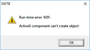

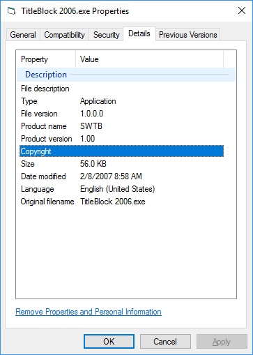

So I have an .exe program that a former co-worker wrote. This has worked for me since 2006 version. It has not quit working and I cannot figure out why! It is a program that when opened allowed me to put my information to fill out my custom properties in my parts. This was helpful since there are a few fields that are the same on a project to project basis.
Here are the properties it would fill out
This is the error I am getting now
This all worked until last week when I installed 2015 back on my system as a customer requested I use SW2015 to design a project in.
Any help will be appreciated.

Since this is an executable file, you need the original source code to fix the problem and compile to a new .exe file, I think

The COM ActiveX component used in the program is not registered on the computer. Most likely reason is x32/x64 incompatibility. So the program is intended to run in 32 bit environment while you are in 64 bit. Do you remember whether this software opened SOLIDWORKS to fill the properties or did it silently?

Were you once running 2015 with this application and was this "TitleBlock 2006.exe" working with that?

I have an update. I uninstalled both 2015 and 2016 from my system. I re-installed 2016 back on and now it works fine again. I put 2015 on a separate workstation.
