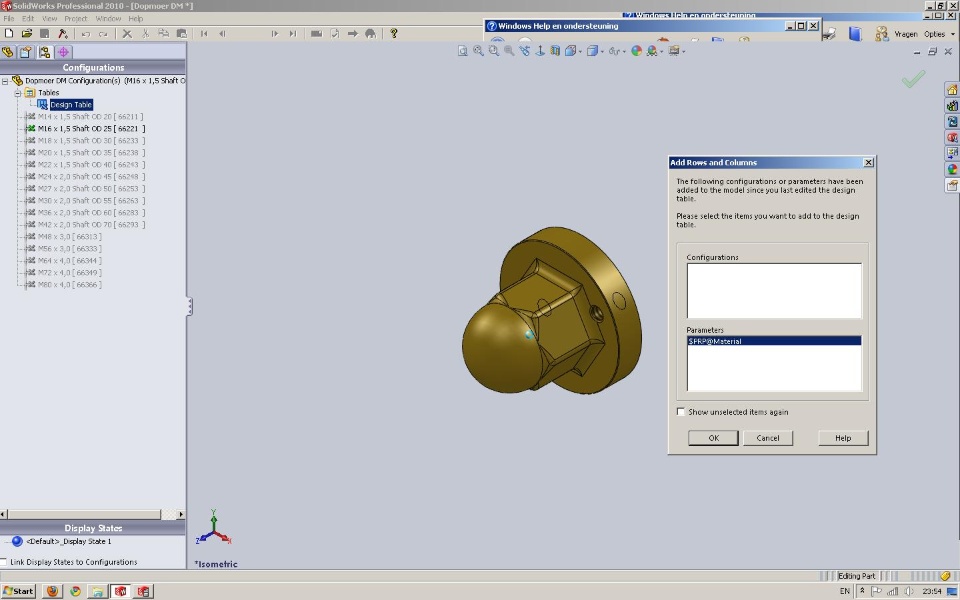

In a part with an already created Design Table Iv'e added the custom property called 'Material'.
When I select 'edit Design Table' Solidworks suggest to add that Custom Property.

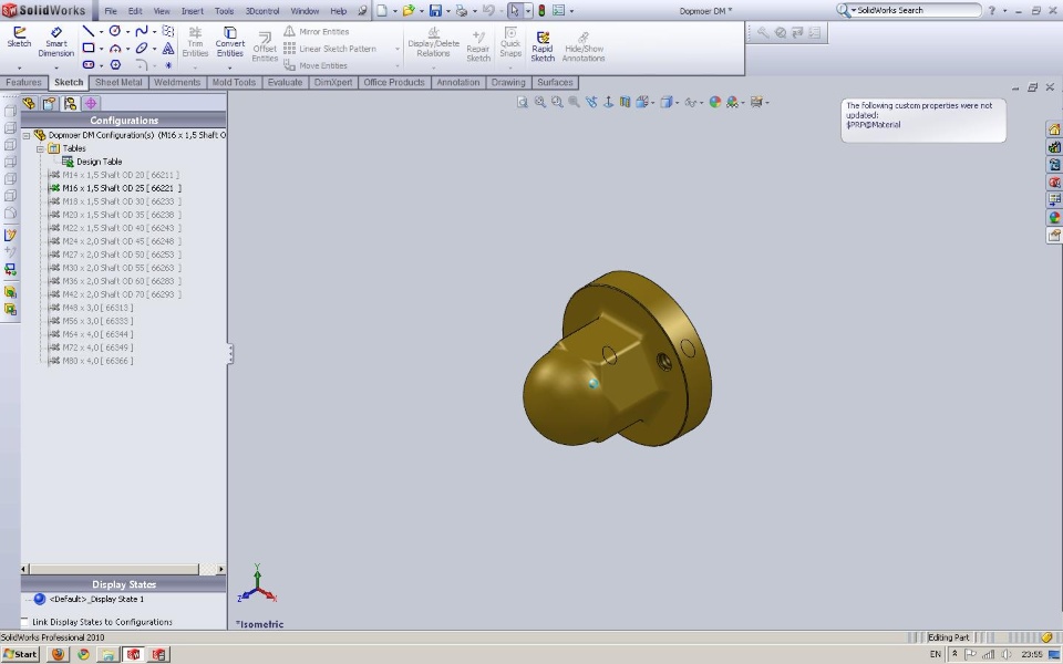

Now, with nothing changed into the Design Table but just select the Green Wink Solidworks is telling me that 'custom properties not updated'.
See pics.

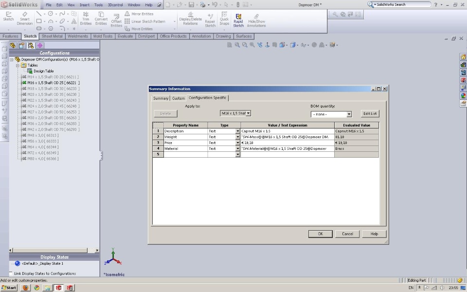

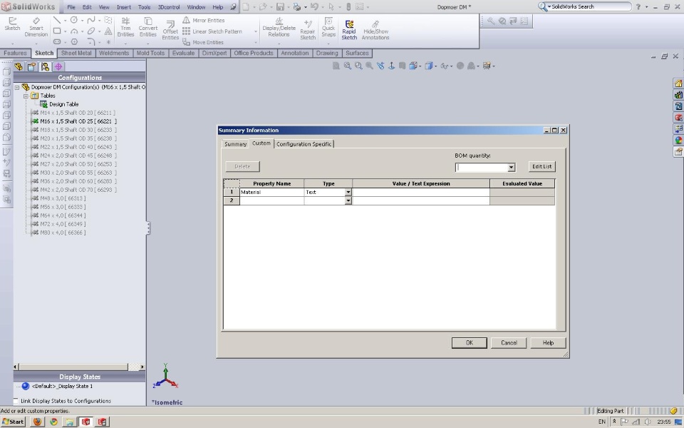

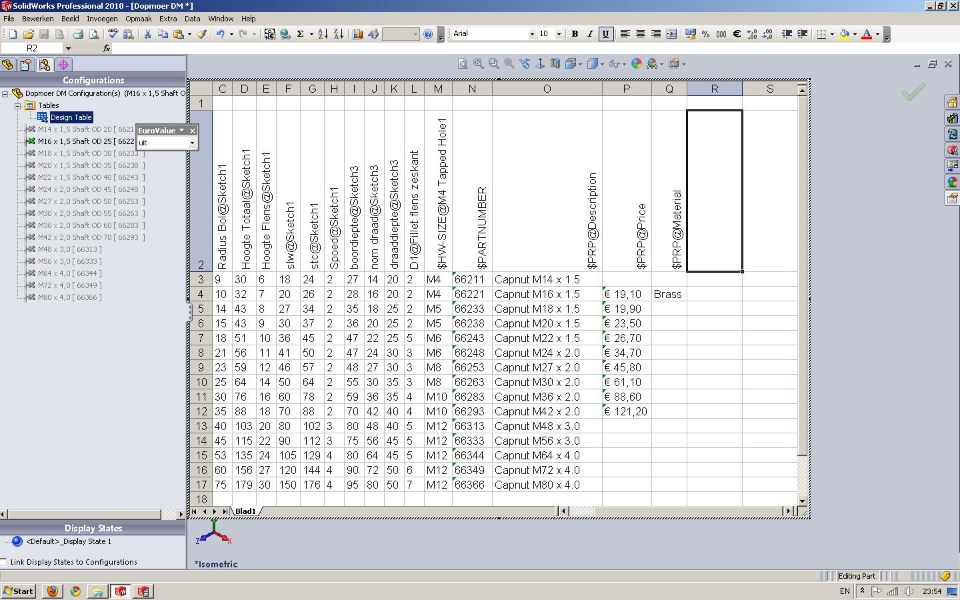

Looks like it's conflicting between your material property which is present in both custom and configuration tab (generally custom specific property takes over any configuration specific property with same name). Delete the material property from the custom tab and design table. Then re-edit your DT and select the material property. The DT should get updated now (if you don't see material property in the list under Add Rows & Columns window, select Show unselected items again)
