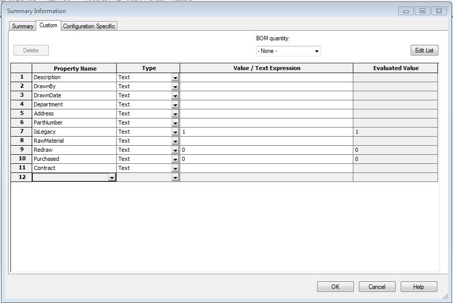

Ever since we upgraded to 2013 the custom properties drop down list in the document properties window is empty. Where did they go and how do I get them back.
Thanks,
Larry Corbin
Thanks,
Larry Corbin
Larry,
Make sure the properties.txt file is in C:\Users\All Users\SolidWorks\SolidWorks 2013\lang\english
If it's not check C:\Users\All Users\SolidWorks\SolidWorks 2012\lang\english and see if it's there, then you can try copying it over.
