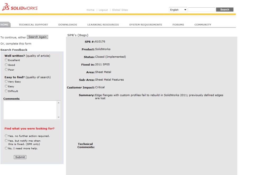

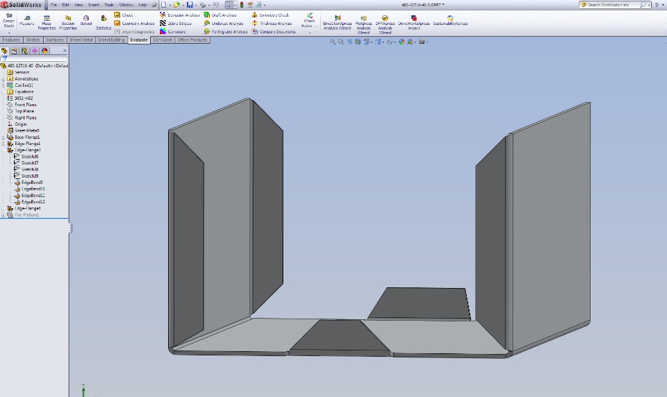

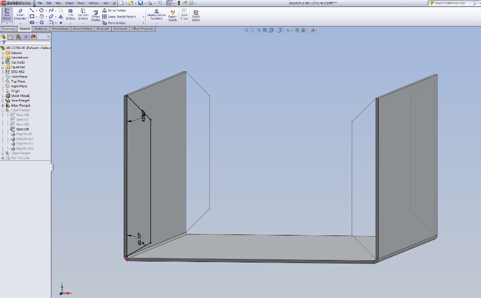

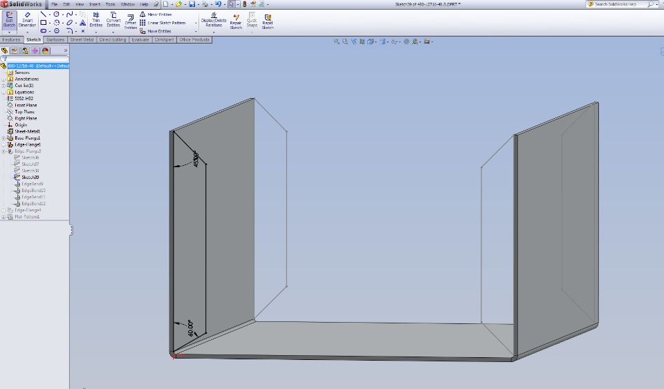

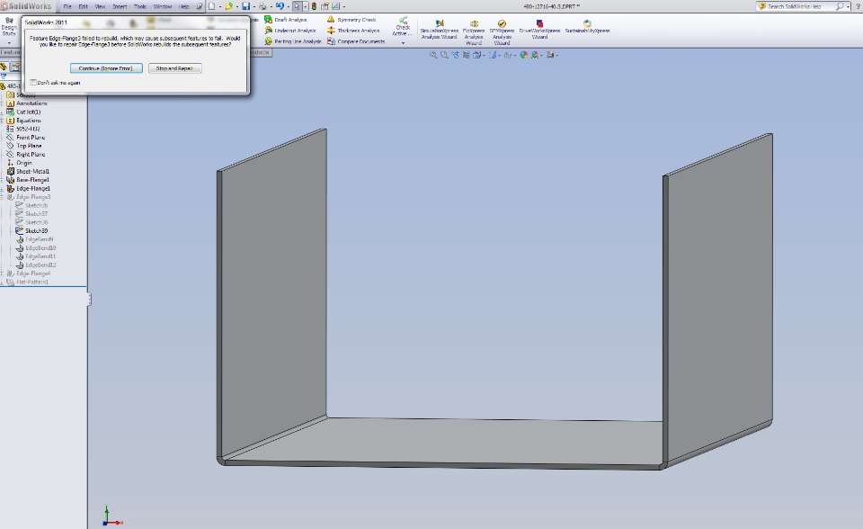

Ok this is weird. I want to put a 45 on the corner of a flange like i have done thousands of times on sheetmetal parts. For some reason, on the last flange sketch, I cannot get the last 45 to work! The whole flange series fails when i go 60 degrees or less (see attached image). SW 2011 SP 5.0 is what i havw. I searched the SPR's and found a similar reported bug (SPR 610176,see attached) but it says that this was fixed with SP 5.0. Anyone else find this issue?

I am on 2012 and your part works fine, so it could be SW 2011 SP 5.0.
Couple of things I would try is; do the edge flanges on one side and than use the mirror feature and see what happens.
The other way that will work is to make the part in extrude feature, (not the sheet metal feature), than insert the bends.
