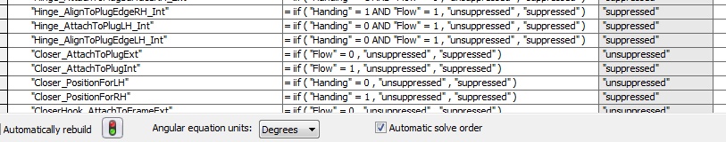

Hello,
We are working on an assembly where we need to be able to control the suppression state of a number of features and components via equations. I've attached an image showing a sample of some of these equations. In this case, "Flow" and "Handing" are custom properties of type 'Number', and values of 0 or 1 are used for them. The problem comes from the need to adjust the values of these properties in different configurations of our assembly. For the life of me, I cannot seem to get the equation to use the 'Configuration Specific Property' value for the *current* configuration. The equation always uses the value of the first config in the list.
