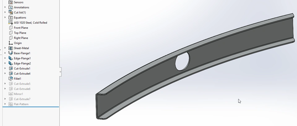

Can this part be made in sheet metal, in a way that can be flattened? I started with the top of the u channel and used edge flanges to pull down. But even the arch from the first step can't be flattened.
Maybe I'm better just not using sheet metal features.

Okay. Its the trim at the ends that was keeping me from flattening like you did. If I suppress all that I can get a flat pattern. One of the proposed end trims below. Would be much better if I could figure out a way to unfold, cut and refold.

No, not the way it appears that you have it drawn. The only way that I see that it can be done in Solidworks, is to bump-break the "web" of your channel with the lofted bend tool then add edge flanges between the bends for the legs. You'll get  a part that shape that should flatten out in Solidworks.

You can do this in SW sheet metal, but only one edge per curved edge flange is permitted. So you will need to add a second edge flange operation. But for the 2nd flange's distance, set it to vertex and click the tip vertex of the first edge flange so they remain equal (assuming this is required).
Keep in mind this is dual bending, so SW's flat may not be the most accurate as the edge flanges will be subjected to some puckerage. Test pieces are recommended.

This is post-sheet metal work. Can you add an arc'd tab at the end that's inboard of the form lines and call it close enough?

Second flange did work, then trimming with chamfers and asymetric fillets did make the part. Close enough as you say. I lose the second flange when I flatten, but for conceptual work its good enough for now. Thanks!

Why not a Swept Flange?

I hadn't used that before. I could duplicate it, but in the end it gets me to the same place. I can flatten, but not unfold.

If you want to unfold and fold this you could add a tiny flat in you base flange sketch. I'm using 2020 and don't have the luxury of adding a flange onto a bend edge so I did this with a Swept Flange but was able to unfold and cut extrude the center hole and ends. The only caveat is you will have the tangent edges show where you inserted the the tiny flat. Of course you can not display the tangent edges. Adding the flat will have an unmeasureably small deveation in the flat pattern.
