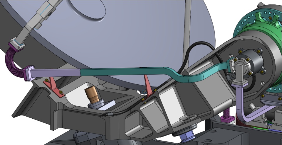

I'm working on a gimbal system for the International Space Station.  On my two axis gimbal I have to transfer RF signals from the base out to the payload.  One frequency is such that I have to use a Wave Guide system.  As part of that I'm incorporating a curved, approximately 135°, flex section at the antenna interface.  The flex section is made by hydroforming a peice of copper into a square corragated(sp?) section, forming to get the correct bend, heat treating to stress relieve and then brazing on the end fittings.  I have a rough model as can be seen in the picture below.
I need to perform analysis on this item to ensure it can withstand the launch environment combined with misalignment stresses.  Can anybody help me with how to accurately model this curved accordian type shape?  Thx!

Crude but It may lead you in the right direction.
CC
CC 2010-09-03
Deform and Flex can give slightly different results. You will have to try both and evaluate which follows the material properties more closely. Neither simulates the bending properties of copper, that you will have to do by hand.
Here is a thread showing the difference between deform and flex: https://forum.solidworks.com/message/87630#87630 (Dwight Livingston's post at the very end of that thread)
The best option for a "direct modeling" approach (one that does not use a modifying approach like deform) is to use the sweep tool with guide curves. I have attached a SolidWorks part where I use the sweep with guide curves option. I just did a quick sketch, you will obviously want to be more rigourous with your sketching.
