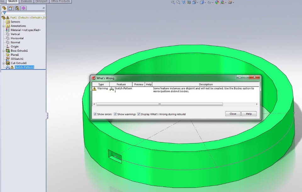

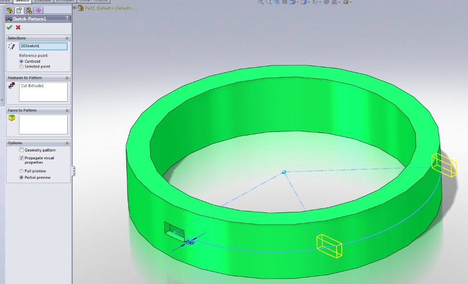

I tried a sketch driven pattern with a 3D sketch, with points located on the surface of part.  The extrude-cut is located on a plane that is tangent to the surface, and the origin of the sketch coincides with the first point of the 3D sketch.  This appeared to let me put the feature instances where I want them in the preview, although the orientation is still parallel to the original - but they all failed when I finished the operation!! Curiouser and curiouser....
I've attached a couple jpgs showing the preview and the result.  I need to have the extruded rectangular cuts normal to the surface of the ring.
Somehow there's gotta be a way - I can get there with a hole wizard, but the hole wiz creates a revolved cut based on an axis that is perpendicular to the surface and located at the reference point of a 3D sketch.  Is there a corresponding method to use an extrude?
I hope I'm not beating a dead horse here - thanks for all of your input.  I know the example doesn't look like much, but the real part that I need this for is a steel weldment about 30 ft diameter with a repeating collection of extuded cuts every 5-12 degrees.  It's a real pain, and this would help a lot!
