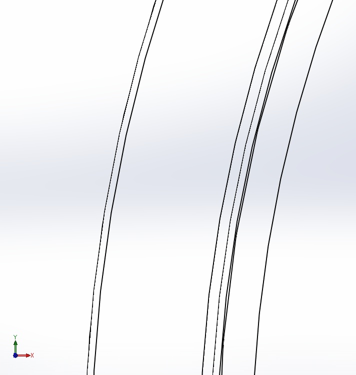

Hi All,
This will be an easy answer for someone I am sure.
I have just got a new video card installed.
All of the curved edges are showing up as straight segments when i zoom in.
Does anyone now how to make them curves again?

BT
BT 2013-08-29
Hi Anna,
Thanks for your help again.
Please see the screen shot below.
comment imagecomment image
AW
AW 2013-08-30
Check these other two boxes as well.
Do a Control-Q rebuild after toggling those settings.  Save your assembly afterwards.
Cheers,
Anna
BT
BT 2013-08-30
Thanks Anna!
That must have been the problem!
Thanks for helping me out!
