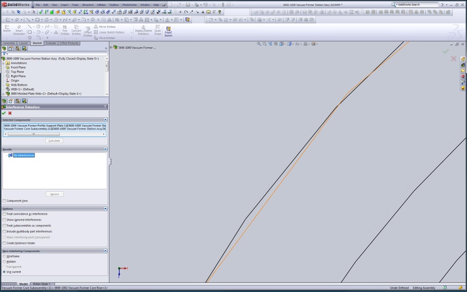

I'm reasonably sure I'm missing something simple(hopefully!). When checking through an assembly, I often try tozoom up on close fitting parts to check for interferences. However,the curves obviously start getting a jagged appearance and itbecomes difficult to see if one part (say a dowel pin) is smallerthan the hole it fits in. Is there a simple SW command to force thecurves to regenerate for smaller increments?
I've tried fiddling with the Display/Performance slide bars in theOptions menu with little (if any) success, especially in anassembly file. The AutoCAD equivalent command was to just changethe "VIEWRES" to a higher number and/or just type "regen" toregenerate the display. I know under Performance you can havecurvature generation to "Only on demand", but how do I specifically"demand" it?SolidworksParts And Features

Did you tried playing with the level of details option underTools > Option > Performance.
Moreover instead of zooming use the interference detectiontool.

I've tried Options>Performance, but it doesn't seem tochange the view at all. I'll play with interference detection abit, but sometimes I'm more interested in how close the parts arecoming without actually interfering (like mold design). I'veattached a screen shot as an example.

You're looking for docment properties>image quality (intools>options).
I think I'm with Deepak on this one, visual for quick inspection,interference detection and measure tool to make sure.
