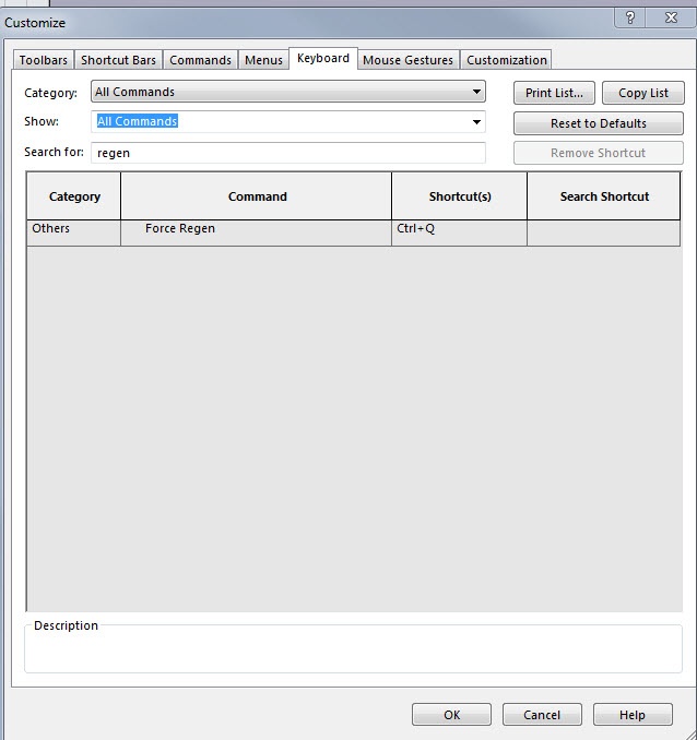

It dosn't do anything in assemblies, but works in parts
mine just says "Force Regen"
see attachment
GH
GH2014-01-10
You have to have an assembly open for the "force regen top level assembly" to show. If you only have a part open it just shows "force regen". Works fine for me in 2014.
see attachment
