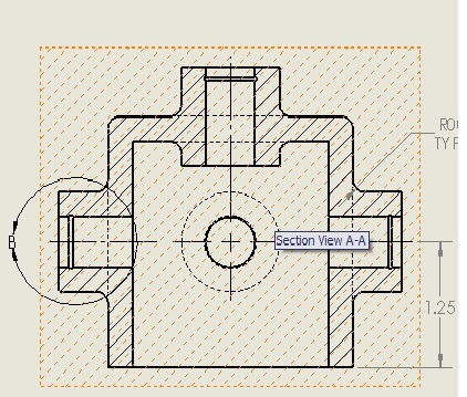

What is this cross hatch on my section view that I can't get to go away.?
Whenever I make some changes to the part or the drawing it will put this hatch in there and I can't get rid of it without deleting the section view and making it all over again.

from the picture, it looks like your drawing view just needs rebuilt
-or-
your section line isnt going all the way through the part with "partial section" not checked
anytime i have seen this and nothing qwas wrong with my section line, ctrl+Q always fixed it

It's simply Solidworks' way of telling you, your drawing view is out of date and needs to be regenerated. To regenereate it use Ctrl+Q / Ctrl+B, or simply click the rebuild traffic lights.
To have the drawing automatically regenerate these for you, right click your drawing in the feature tree and select "Automatic View Update".
