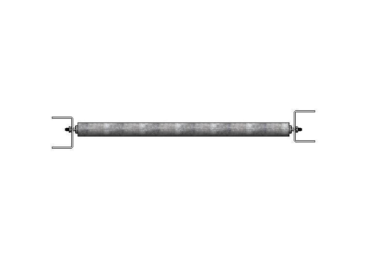

     I am trying to create a smart component, containing (2) nuts, (2) flat washers and a roller. I am building a roller conveyer. I want to coincident the roller assembly onto the legs of a (2) channels, there are (69) rollers required.
    I tried to make smart the shaft diameter and a hole in the channel leg a concentric mate and one of the faces on the washer to be coincident to the channel leg.
Does anyone have a suggestion? I have attached the components.

I don't have any real experience making smart components, but it strikes me from your description that patterning would be a more efficient way of putting in 69 rollers.

The holes in the channel are patterened. I didn't pattern the roller assemblies because I want to have the rollers roll in a simulation with a gravity constraint.

      In this case there is only one size shaft, the purpose of this assembly is just an exercise in studying the SW environment. (Maybe, later I’ll practice with a DT in this conveyor assemble, but that is for another study.)
Now, I have created a sub-assembly of the roller. It consist of the roller, the shaft, and (2) nuts and bolts. Then created a mate reference in the roller sub-assy, to the shaft and the washer face, but they were not translated when they were inserted into the new assembly.
      I have used the smart mates, after the roller sub-assy was inserted, I selected the shaft and used the ALT key and dragged to a hole in the channel for a coincident mate. The selected the face of the washer with the ALT key selected the face of the channel for a coincident mate.
      I was hoping that I could insert the sub-assy with one action by selecting a hole while inserting the sub-assy instead of having to do (2) mates per sub-assy. (69 times in this case)

I understand that you need to have all objects independent.
So another option may be useful for you.
This is a "Copy with Mates"
In this case concetric mate leave as is,  and coincident select repeate.
Click on a hole where you want the next component, and press enter. and go to the next hole

Excellent Tomasz, It worked like a charm. This is what I was looking for.  Thanks very much!
