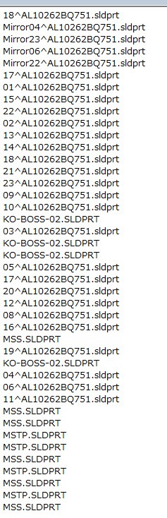

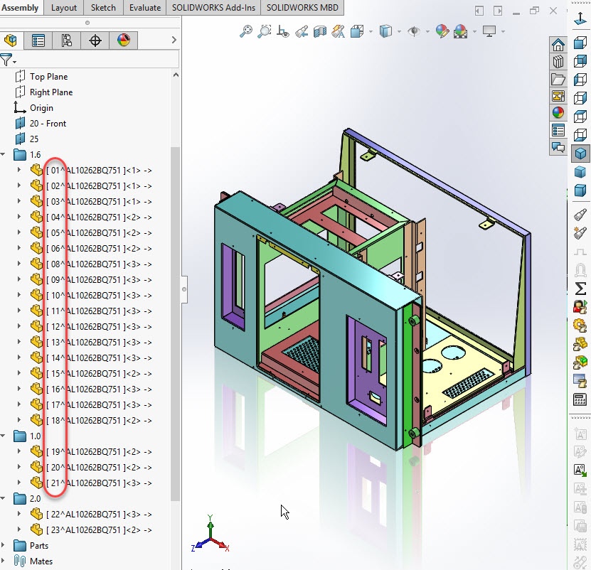

I'm trying to write a macro that creates a list of all components in an assembly and does some actions on each one.
As you see in the following images, the list that macro gives me is not in the order of the components in feature manager.
How can I have the given list match the order of the components in feature manager.
thanks for any kind of help.
