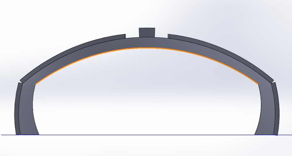

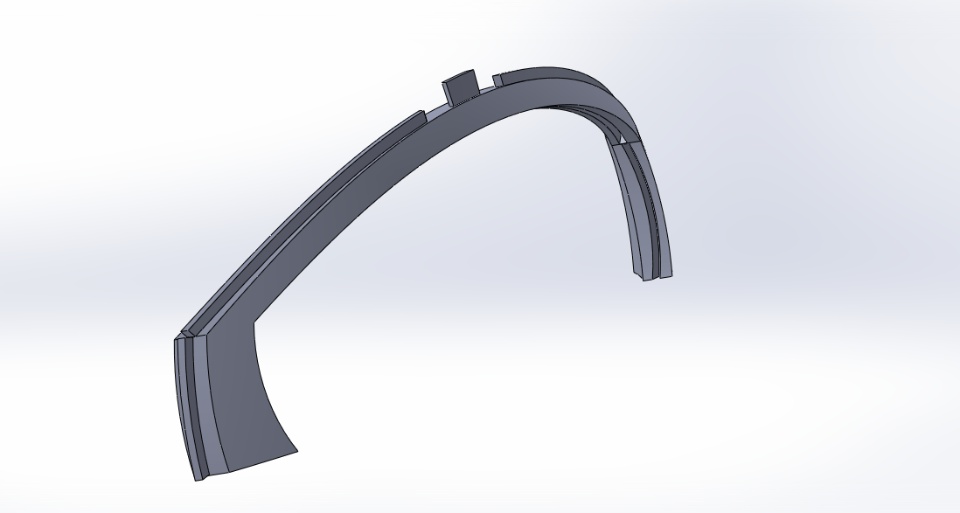

Hey guys so here is my delima, I created a rim system for a lens using the Wrap feature.(1) But I can't figure out how to make the rim one complete piece, using the Wrap feature it seems I get a gap at the edges. (2) Another thing is the rim is supose to go into the rim-slot. So I was wondering if you guys have any suggestions on how to make them line up easier to fit into each other? Attached the pictures labled RIM are from the first problem and the pictures labeled Pocket are for the second problem. Thanks for the help guys, I appreciate it.

I am not sure I understand how you made the part and what your problems are. Did you use three separate Wrap features to add three ribs onto the sides and top of your Rim part? Do those ribs actually match with your mating parts, except where the breaks occur at the corners?

Yeah I did three different Wrap features, one on top and each on the sides. Is it possible to do one wrap for all 3 contours? I dont think they match up because I just put them on to show my employer the design. But do you have any ideas on how to make it line up well?

I don't know of any way to make the Wrap work on the three sides. It might be possible, but I don't have access to SolidWorks right now to try it out. I would be inclined to use surface tools to make your rib. You might be able to project a Split Line on the three faces that would give you the base of the rib. Offset the three facesto the insidee to get the base of the rib and to the outside to get the outside of the rib.Extend the center face and the two side faces until they intersect, then use Mutual Trim to make the complete outside surface. Use Boundary Surfaces to make the six side walls, between the inside faces and the outside faces. Thicken to make it solid. Merge it with the Rim.
I don't understand how the rim is supposed to go into the pocket, unless you mean the pocket is on another part. To make the pocket, I would offset surfaces from the rim by the clearance that you need and then Cut with Surface.
