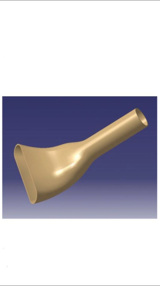

Ive been looking over this model, but can't create it. I'm not sure how to do this, I'm still kinda new to solid works.

Create the planes, sketches and one single loft

.. since the drawing is not exact,... it leaves some interpretation..there are a few ways to do this and Deepak shows the most direct/simple way to do this.
..so, I have another but it takes a few more steps....   try and work through each step and see if you can do it?

Thanks for your help. I really appreciate it, but I still cant get it. Heres my final part. This is as close as I came to creating it.

You can use the surfacing tools to get the desired shape.

Here are first few main steps you need to take.
And then either loft in one go (could be tricky to get the shape) with thin feature or better do in 2 or more loft features (both ways with centrline option).
