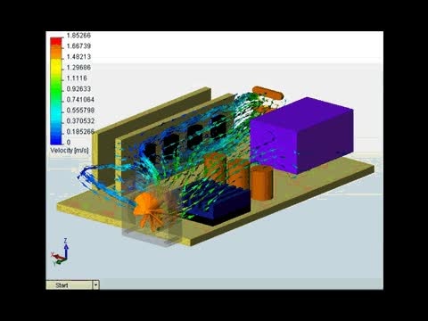

Create trajectorywith rotating fan ?
Hello...
Any body can give me guide to create trajectory & rotating likeattached animation ?
Thanks ~~~!!!SolidworksFlow Simulation

Hi Ahmad,
Flow works animations can beu used similar to Solidworks animator.You can create keyframes and store different view points. If youright click on the assembly tree while editing an animation you canuncheck the "Lock Orientation" option. Once you have done that,move the time bar (drag it) to a particular time frame and theninsert a control point to store the view zoom information. You cantoggle the lock orientation on or off to protect your settings.
I am usure about the rotating fan though.
Cheers,
Ian

Hi Ian,
Yes it works. But I still try to get smooth rotation...

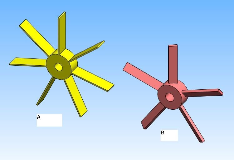

The next case is :
I have a mixer system with a "blade" in the rotary shaft.
I want to analyze the trajectory of using the A vs B blade below.
How to setup and calculate that ?
Thanks !!!

Hi Ahmad,
If you want to analyze a rotating fan, then you need to use therotating region approach. You will not see the fan animate in theresults, but it correctly accounts for the flow through the baldes.There are examples in the Flow Simulation tutorials for rotatingregions (rotating impeller, CPU cooler).
Also read the technical reference guide in the installation folder(in the lang folder under docs for your given language). This willgive you understanding of the theory and application.
