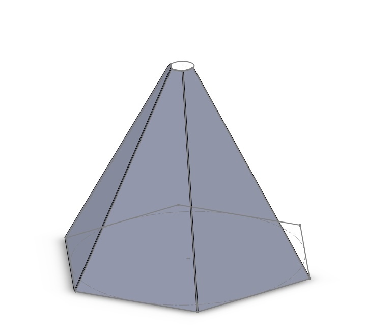

Hello all,
I want to take what I have built (using 3 different planes, and extruding), and convert it to sheetmetal so it can be flattened, and thus corrrectly dimensioned. The actual piece will be built from one piece of plate and bent on a press brake. Any tips for me?  I am sure there is an easy way to do this that I am missing.
Thanks,
Lee

Lee, it's going to go better if you create those three panels as flat faces (surfacing toolbar), knit them together, thicken them and then do insert bends so that the joints are mitered.
If you have to work from what you've got then you'll need to fill in the corner joints by creating extrusions
SF
SF 2013-09-13
Why not Extrude it as a 6 sided Solid if you know the resulting angle and use that as the Draft Angle. Then apply a valid outside radius for that material thickness and bend style. Then Shell to the material thickness, then cut in half suitable to your welding capabilities. Convert to Sheet Metal last.
