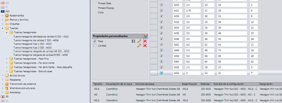

Hello,
I've SW 2014 SP3 and in this version SW has "Additional Properties for Toolbox Components":
"Three  read-only properties, Part Name, Standard, and Specification, are available in Toolbox settings and appear in the Configure Component PropertyManager for standards  that have an existing Designation, such as AS, DIN, GB, ISO, IS, and KS. The properties are available in drawing or  assembly BOMs."
http://help.solidworks.com/2014/English/WhatsNew/t_toolbox_property.htm
I think there is a problem with the new property called "Specification".

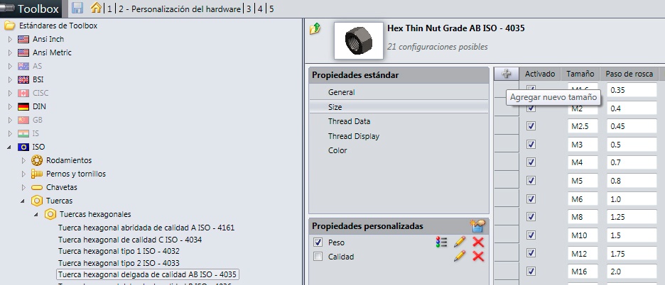

To create a new size, for example, for a new M14 ISO 4035 nut i go to toolbox and go to add new size:

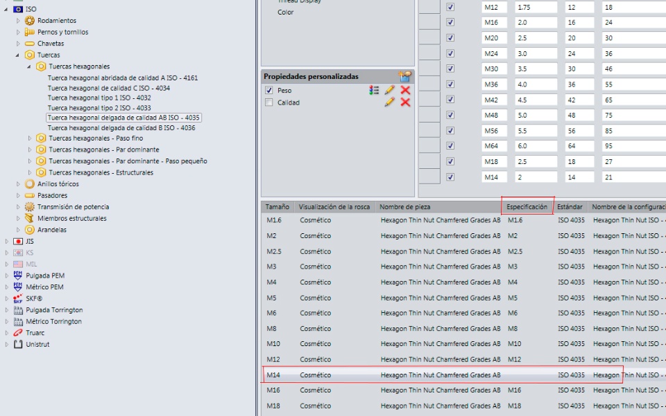

And in the new column, "Specification", there isn't appear the specifitation for M14, there is a gap and for this reason i can't insert the new nut.
How can i create the specification for the new nut?
Thanks for all

Igor,
Just out of curiosity I tried to add a M14 to the ISO-4035 myself and I get the same thing happening. In other words, it doesn't look like it's a problem for just you. I double checked and indeed a ISO 4035 nut should also be available in M14 and it's strange that it isn't standard included in the offered sizes in the toolbox.
I would suggest contacting your VAR and see what they can do about it. Could very well be a bug in the toolbox.
Have a nice one.
Peter

JK
JK 2015-12-14
Igor, you have problem with geometry which is caused by wrong dimension values in sketches etc.
I had the same problem and reason was, that I used , (comma) instead of . (dot) as a decimal separator for values which defined your new size of nuts.
Please try it
