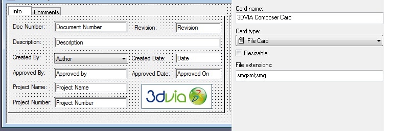

Hi You can create the data card for almost any file type, You will have to define the file extension to assign a particular card.
see the attached picture for more reference.

Can i use * or other symbol to define for any other extension?
SF
SF 2011-02-09
No, You cannot assign any characters as * to define. You will have to specify the extension clearly and separated by comma if you would like to assign same card for different variables.
