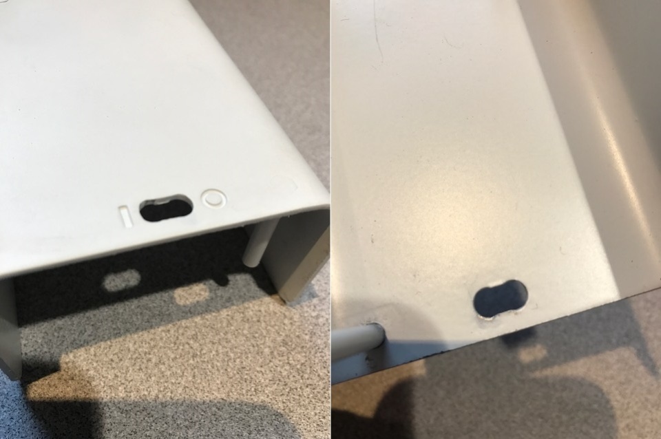

Hi All,     Is it possible to create a form tool to create this coining style feature? All the form tools I have created deform the backside of the material, I can not seem to get one to do this.
We use this pretty regularly and it would save a lot of time,, as we draw it out each time
It does not distort the backside of the material [see image]
Thank you in advance,
Kevin

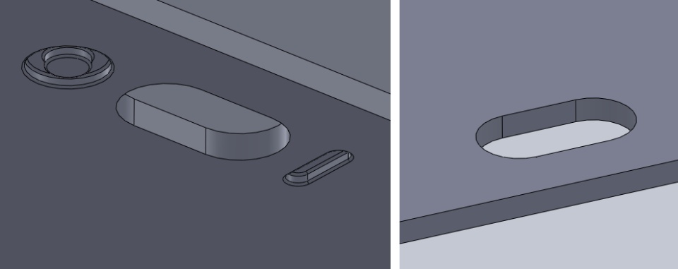

Ok, thank you. however its been years since I have created library features and I can not seem to get this one to work.
Any help would be greatly appreciated.
I have attached a small part file with the features on it.
DG
DG 2017-07-25
Do not create a sheet metal for it but use simple extrude for the base. And make sure you do not constrain it to base.
KR
KR 2017-07-25
Thank you!
worked like a champ, its been too long since I used that feature.
