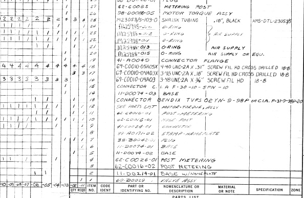

My company has a very specific format for our BOMs (photo attached). I have a few questions to be able to use SW's BOM.
1.
I need to be able to have a blank row above the Footer. When I try adding a row and moving the parts up a row, the item number then start at 2 because SW thinks the blank row should have its own item no. In other words I want Item 1 to start in Row 3.
2.
When adding a column, is there a way to have no column property attached to it? This is a similar problem to number 1, I want completely empty cells that have no formatting.
3. If my main assembly has more than one configuration, is there a way to add a new column (the new config's QTY) for each configuration, and have SW automatically populate with QTY (assuming all configurations have been done correctly in the assembly/sub-assembly models). Another way to ask this question: is there a way for different columns to populate the table with quantities from the assembly’s different configurations.
These questions are hard to convey through writing, please take a look at my example BOM, I want the SW BOM to look and act just as the example BOM does.

I can answer 2 for sure, and I think 1.  If you highlight a column in a BOM, you can right-click and choose "Insert Column" and then choose "Right" or "Left".  (I'm at home now and don't have SW here, so I'm not 100% certain about the terminology, but that should get you there.)  After you have made your selection, if you just click off the BOM, without making any selection in the Custom Property drop-down, you will have a blank column that isn't linked to any property.  You can add any text to it as you want (or leave it blank).  I believe the same procedure is true for rows, but I don't remember for sure if I've ever done that.

Thanks for the quick response. The unformatted column is correct so thank you. However, if a row is inserted then the cells automatically take on the formatting of the column they belong to.

Before you insert the blank row, click on the cross at the upper left corner of the BOM to bring up the BOM's PropertyManager.  Click "Do not change item numbers" in the "Item Numbers" section (the padlock icon).  Then you can insert the blank row and your item numbers won't change.  SW will insert the next number in the item number cell of the blank row, but you can double-click in the cell, highlight the text, and hit your space bar.  The cell will then show as blank.  You have to hit the space bar for this to work; if you hit Delete it will come back.
I would advise not adding the blank row until you've finished organizing your BOM because if you choose this option and then re-arrange rows the item numbers will get out of order.

Thanks again. When I follow that procedure, I can make a blank row (or at least a row that appears blank). However, when I go to insert the next item, the blank row still has an item number assigned, so my BOM appears to skip a number. This works as long as the blank row is the last item entered in, but as you can probably imagine, having to do this every time a new revision adds something to the BOM would be a pain.
All in all this works, just not as smoothly and conveniently as I would like. Thank you for your help.
