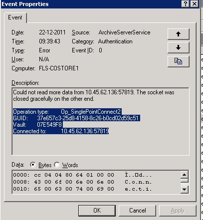

Could not read more data from 10.45.62.136:57819. The socket was closed gracefully on the other end.
Hi friends,
Our prduction server having below error frenquently..
Operation type: Op_SinglePointConnect2
GUID: 37e657c3-25d8-4158-8c26-b0cd02d59c51
Vault: 07E549F8
Connected to: 10.45.62.136:57819
Is it releated network?  How to identify whether this occured due to network?
Regards
Kumar

What machine is 10.45.62.136? Is that an archive server?

It is EPDM client not archive server.

Encontre la respuesta a mi problema:
La solucion era que la red estaba configurada para PDM 2011 y en una maquina habia instalado PDM 2010 y mostraba el error:
Por lo tanto era solo desinstalar PDM 2010 y volver a instalar PDM 2011, para que se corrija el programa.
