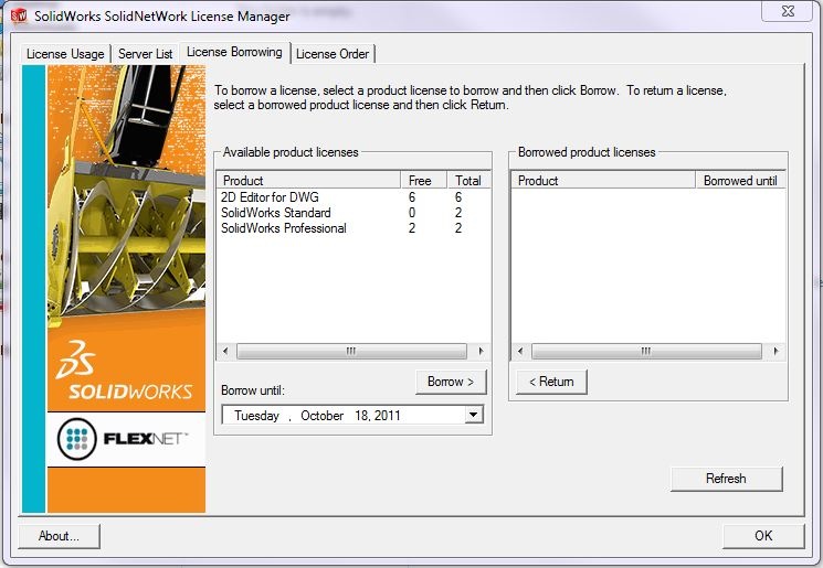

I have attached a file of the license borrowing tab of the license manager and it shows that i have 2 standard lic with 0 available.
There currently is not anyone using the software.

Solidworks Professional not Premium.
AW
AW 2011-10-18
Check the license usage tab to see who has the licenses checked out.
I would have the IT guys restart the license server to flush any stuck licenses.  I would also restart your compter as well.

There are no licenses checked out. I will discuss with out IT tomorrow. Thanks for the info.

It turns out that our IT forgot to activate after upgrade. Thanks for all the advice, all is well now.
