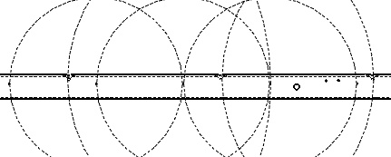

   I'm trying to track down why cosmetic thread blow up with I rebuild a drawing (Ctrl-Q, or ForceRebuild3(false) from the API).
   I encountered a bug w/ the BOM where individual components wouldn't show up within a sub-assembly--only the sub-assembly shows up as a line item.  The configurations w/in the sub-assembly as set to "Promote", so the sub-assembly should be dissolved and all of the parts should show up in the BOM.  The BOM items showed up properly when I open the drawing, but when the PDM Task script to convert the drawing to a PDF grabs a hold of the drawing the BOM only shows the sub-assembly instead of the parts.  I added a "ForceRebuild3(false)" line in the script and that solved that problem.  However, now I'm seeing cosmetic threads blow up.
Drawing opened up.
Drawing Rebuilt (both through Ctrl-Q and through ForceRebuild3(false))
Any way to suspend rebuild of cosmetic threads when using ForceRebuild3?

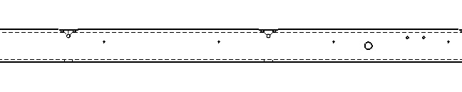

I have seen this in older releases....editing the thread feature in the part and closing the dialog box fixed it.
Without making changes to the thread settings. A rebuild fixes the display in the drawing.

how old are the cosmetics thread features? SW2019 revamped the cosmetic thread code, but you need to specifically tell old ones to convert to the new code...
2019 SOLIDWORKS Help - Upgrading Legacy Cosmetic Threads
