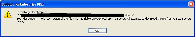

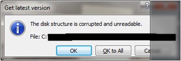

A week later I started getting calls from one of the engineers there that he was getting error messages saying "The disk structure is corrupted and unreadable" or "The latest version of the file is not available on your local archive server. All attempts to download the file from remote servers failed."
I simultaneously started getting emails from IT that the backup agent was reporting folders that were corrupt and unreadable. These folders were inside the EPDM data folders.
