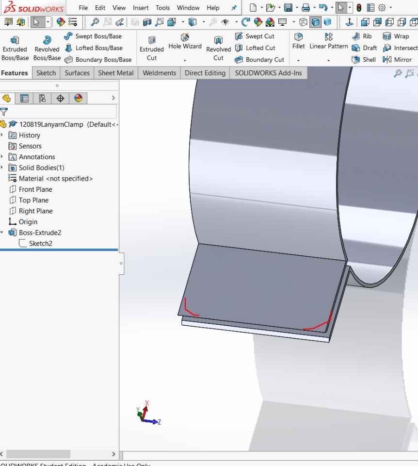

Corner sheet metal fillets.
I'm trying to get these corners to fillet but it's not working for me. I'm doing something wrong.
Maybe I should have make this model in sheet metal since it's supposed to be a sheet metal piece ?

If I had the Edge flange settings wrong, then I needed to be corrected on that. The Edge flange offset selection buttons did not respond either.
But as it turns out in Base flange the problem was the reverse direction button didn't react in the sheet metal parameters. Why ? I'm not sure. I tried that a couple of times before with no response from my software. Even thought the Arrow was pointing in the direct it is in this screenshot. I just tried it again and now it works. Its' not uncommon for my to have these software glitches but then again, no body mention reverse direction.

F. Leatin wrote:
" R.3 inside + .3 thickness = .6 = collision.
And that's just one flange.
If your .5 gap is the final separation, you must account for it in the bends. "
Great engineering speak Mr. Chandler. Unfortunately I not sure what it is your trying to say.
Hello,
You stated you wanted a .5mm gap.
You add a flange which consists of an inside radius (R.3) with a flange that is .3 thick.
Starting with .5, adding .3 twice puts the flange beyond the gap (or most of it since you're on the outer radius as shown in this clip from your image:
If you want a final gap of .5 between flanges, the starting gap before flanges must be increased.
Kevin
comment imagecomment image

F. Leatin wrote:
I was only trying to make a visual example of an idea I have so I just made it as a sketch since that was the fastest an easyist way.
Now I'm trying to remake the model in the sheet metal mode but I'm having problems since I can not find any video instruction online on how to make this happen. I've got the rolled base flange done but I'm not sure as how to make the 7mm tabs fit the way I need as shown in previous example with a .5mm gap between them.
Kevin
JM
JM 2021-04-08
This is all you need in your sketch - SolidWorks will automatically put in the Bends for you. (And add the thickness to open profile.)

F. Leatin wrote:
Too late, I figured it out. Sorry.
Sorry, but not really.
You have violated two sheet metal rules.
As indicated by ‌
1. Part is not uniform thickness.
2. No bends.
comment imagecomment imagecomment imagecomment image
KC
KC 2021-04-08
Hello,
The OP title state sheet metal but this model isn't sheet metal.
Sheet metal requires tangency. It also requires normalcy, which this model doesn't have.
The chamfered edges aren't permitted for sheet metal and the R0 inside radii at the bends aren't feasible either.
The chamfering would have to be the last operation (or an earlier op with no dependents) and it would be unsuppressed in its own config.
This as a sheet metal part:
I used sheet metal's Break Corner for the rounded corners, but if you chamfer the edges (which isn't too feasible with 0.3mm thick material), you will need to use the fillet command and have the two ops in their own config. And their order may alter the outcome.
