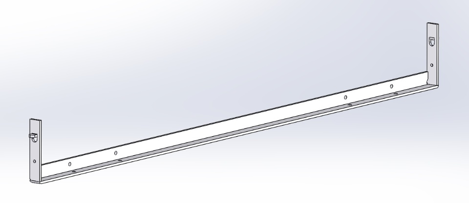

Hi,

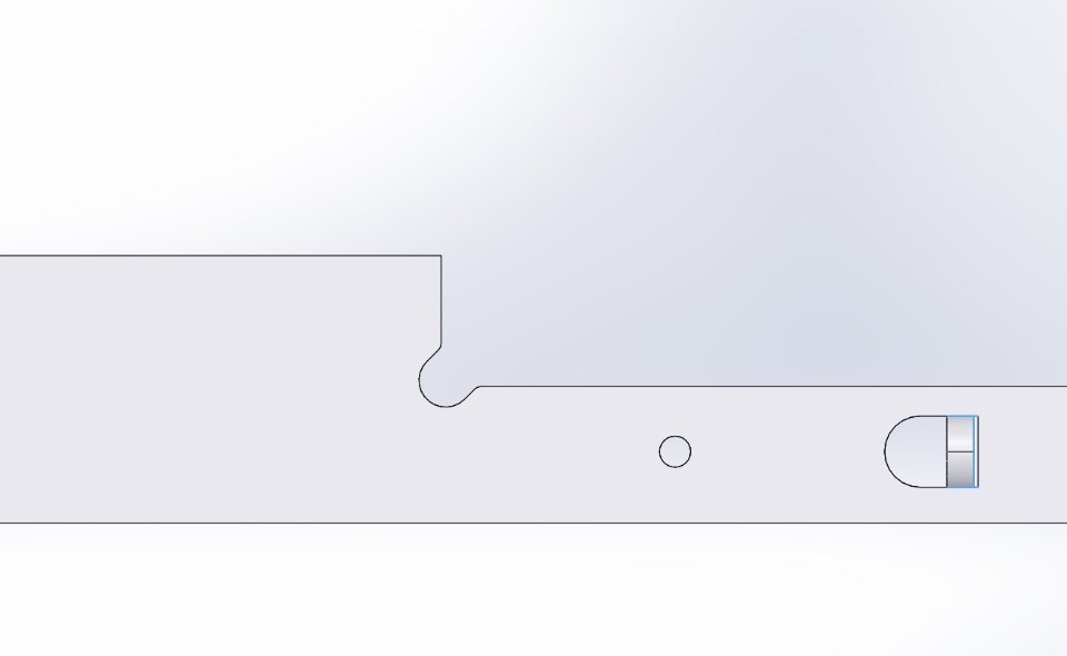

I'm about to draw this part, and I don't know how to make the corner reliefs.
I have to match the original model where the corner reliefs looks like the below, so therefore I can't use the ''Corner Relief' options inside SolidWorks.
I have attached my part. I'm open for suggestions on how to draw this.

Unfold, cut extrude, fold?

John: I opened your file and changed the corner relief you had drawn to my own sketch, and suddenly I can't fold it again.
SolidWorks says: "The bend may be fused with other bend"

Victor,, You don't have any really good options when it come to making a bend relief like that. That would require two uniform bends to alter their course and become non uniform in the corners. Compound in the corners. If you don't want to extend the relief to or beyond the tangents you can split it a tiny bit. This makes for a goofy looking corner in the formed model but if you are steadfast in not extending your relief you can probably live with it. You might want to fill in that split in the flat pattern (after "flatten") so you don't accidentally try to tool it.
What I did on the other corner is mirror your sketch and increased the radius. This brought the relief just beyond the bend tangent. The relief becomes more massive but looks good in formed state. I think you mentioned that you have been making a lot of these and probably don't want to change your flat pattern to suit SWs capabilities.. You could also change the angle and narrow the width but you still need to get to the tangent line with it.

Another thought is minimize the bend radius as much as possible and use an appropriate bend deduction. The flat patterns would be the same developed size.with the exception of the long edge of the Edge-Flange1. That will change as the bend radius changes. Of course you can trim the ends back. The folded model will still be the same OD's  When you do it with the smaller radius your tangent bend edges would be closer together which would require less stretching (modifying) of your your current sketch. Note the 1.89 dim. It was 1.6 on your original sketch.
This is what I used but you may have to alter the bend deduction in order to come out correctly with your current flat pattern.
