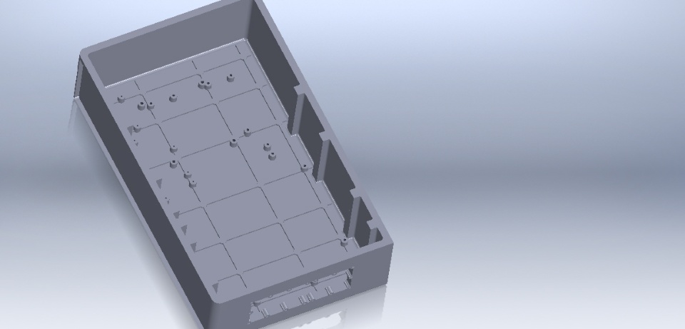

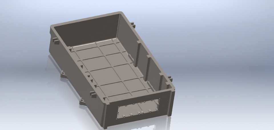

I'm designing a transformer unit control box, in which there are 2 different sized boxes,  the shape and the size are all different , but the base for the 2 boxes are same. In the box1 there are about 250 threaded holes with corresponding x and y axis positions, i made all the holes, It will be comfortable that any option like copying the sketch pattern for holes of box 1 to box2, Need your help.
i have attached the photos of 2 boxes.

The usual copy (Ctrl C) & paste (Ctrl V) of the sketch, should work. Is it not doing so for you?
http://help.solidworks.com/2013/English/solidworks/sldworks/t_copying_and_pasting_entire_sketches.htm
Alternatively you could add all the holes to box1, then do a Save as to box2 and modify that copy to suit.
