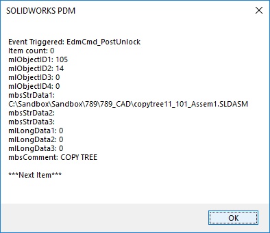

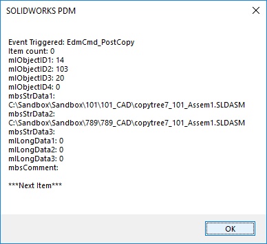

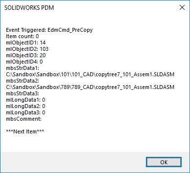

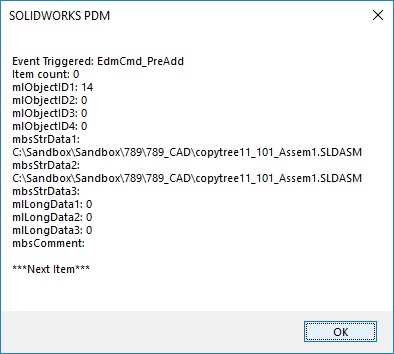

This is the code to add all events (for those that are curious how each event gets triggered):
<p>public void GetAddInInfo(ref EdmAddInInfo poInfo, IEdmVault5 poVault, IEdmCmdMgr5 poCmdMgr)</p><p>{</p><p>//Specify information to display in the add-in's Properties dialog box</p><p>poInfo.mbsAddInName = "swEPDM_BOM";</p><p>poInfo.mbsCompany = "Dmitry Zamoshnikov";</p><p>poInfo.mbsDescription = "The most magnificent description of this wonderous addin";</p><p>poInfo.mlAddInVersion = 1;</p><p></p><p></p><p>//Specify the minimum required version of SolidWorks Enterprise PDM</p><p>poInfo.mlRequiredVersionMajor = 5;</p><p>poInfo.mlRequiredVersionMinor = 2;</p><p></p><p></p><p>// set up hooks</p><p>//poCmdMgr.AddHook(EdmCmdType.EdmCmd_CardButton);</p><p>//poCmdMgr.AddHook(EdmCmdType.EdmCmd_PostAdd);</p><p>//poCmdMgr.AddHook(EdmCmdType.EdmCmd_PostLock);</p><p>//poCmdMgr.AddHook(EdmCmdType.EdmCmd_PreAdd);</p><p>//poCmdMgr.AddHook(EdmCmdType.EdmCmd_Menu);</p><p></p><p></p><p>foreach (EdmCmdType cmd in (EdmCmdType[]) Enum.GetValues(typeof(EdmCmdType)))</p><p>{</p><p>poCmdMgr.AddHook(cmd); // add each hook</p><p>}</p><p>}</p>These are the events that are triggered (in sequential order).
Copy Events get triggered when I copy paste (regular ctrl-c, ctrl-v). Are the copy operations w/in copy-tree not triggering the epdm copy events?
