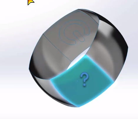

I couldn’t understand why Copy Surface is needed here. There is a surface already why can’t this surface be used in the subsequent operation.

..well, the series is about learning to use surfaces so I think he's just using the 0 offset as a how to example.
Thanks. I am able to do without copy surface.
Thanks for the comments in detail. For the last two days I have been struggling to understand his work.
It doesn't look like he creates that extra surface for any specific reason. If you go through the rest of the series, in the end, he uses delete body on that surface as well as a couple of others. Perhaps he originally planned a different approach but then didn't use that approach so the surface was not needed.
Note that between video 2 and 3, the name of that feature and surface actually changes from Surface-Offset2 to Surface-Offset3. The person who recorded the video probably was just playing around doing something else between recording the two videos leading to the discrepancy in the names.

So that I will do without 0 offset and let you know the result.
