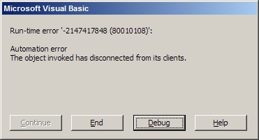

Hi There,
Thanks for the update. I've given it a go and get the following error... Although I am using 2010... Any thoughts?
Cheers,
Marc
DG
DG 2010-06-10
What is your OS. Also did you tried fixing the missing libraries (Open the macro in an editor, go to Tools > references and look out for missing libraries and replace them with equivalent SW2010 libraries)
RS
RS 2010-06-10
Do what Deepak said.
Earlier versions of SW were not nearly as difficult for transitioning macros from one version to the next.  Problem gets bigger with each release.
Unfortunately, I'm still using SW2009 32-bit.  Thats as far as I can take it from here.
SF
SF 2010-06-10
I'm using 2010 on XP
It's strange, that it does actually seem to work once I clear the error... The only thing that does not seem to work, but might not have before is the weight/mass attribute becomes a figure and not the syntax.
