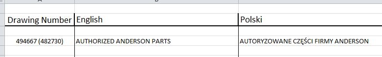

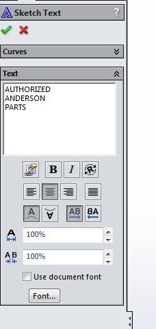

Is there a way to copy text from another source, in this case MS Excel, and paste it into a SolidWorks Sketch Text?  I had to have a bunch of text translated from English to Polski, but I seem to be having problems with copy and paste.  My issue is due to all the accents and other letters which are not on an American English keyboard.  I figured that I'd be able to copy and paste...
Any Help is greatly appreciated!

Yes:-
  1. Select text in your Excel & press CTRL+C.
  2. Open a new note on your drawing
  3. Click on the text box & CTRL+V
AB
AB 2014-04-22
Thanks - can't believe I didn't think of that... sometimes I just need a good smack in the back of the head!
