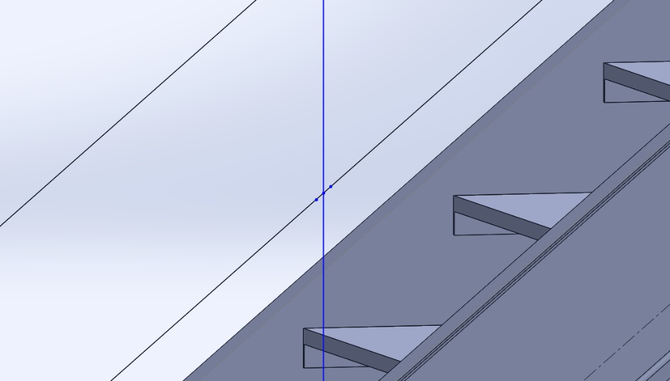

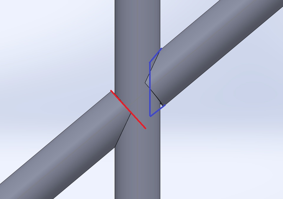

I have a question for you guys... I'm drawing a hand rail for a set of stairs and I use the split method to cut short for coping. Is there any way to get the end of the pipe to be vertical (in blue), instead of running parallel with the line (in red) WITHOUT having to create a plane at the end of every single pipe? You'd think after all these years routing tubing would be a little more intuitive. I was hoping aligning the sketch in weldment would help but of course it just rotates it about the line

I just tried to to play around and come up with what you need and I couldn't get it to work. The only thing I can think of is make a new part of how you want it to look and manually cut the end and make an assembly. I know it's a bad work around. Maybe worth talking with your VAR.

Well you either to use plane and trim OR use cut extrude the remove the material.

Well thanks for trying. Making a plane at the centerline and another plane offset whatever I want the piece coped at and trimmed to it is even easier than that, but still time consuming to do.

I am having trouble visualizing trimming to your blue lines.
Shouldn't it be back here?
Can you create simple two body example of what you really want?
