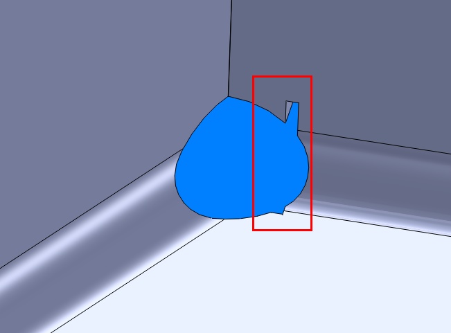

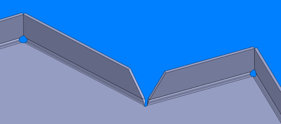

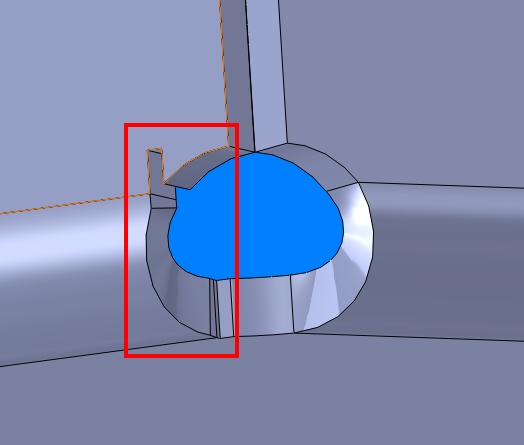

I have an imported part that was created in SolidEdge sheetmetal. I need to convert this part to sheetmetal in SWx so I can get a flat pattern DXF. When I do this, the conversion makes weird cuts in the bend reliefs.
Has anyone seen this or have a solution?

i'm assuming the "round hole" relief is from solidedge.
this type of relief is abnormal to solidworks.
you could change the solidworks relief type to "tear".
there will be an ever so slight cut though.
or just cleanup the flat dxf.
