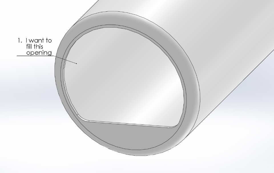

This is an example of what I'm running into:
Start out with this.

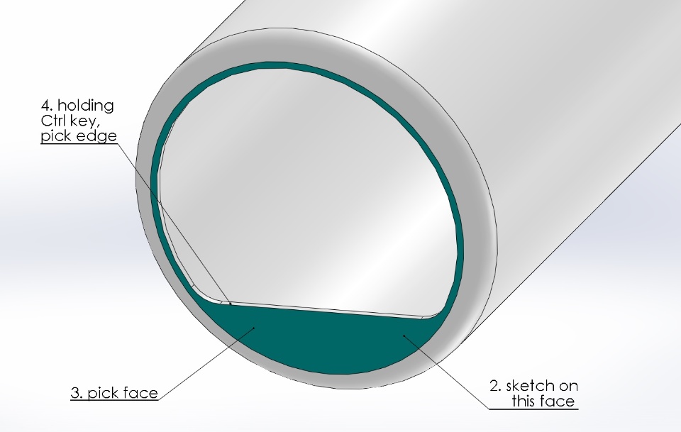

Step 2:

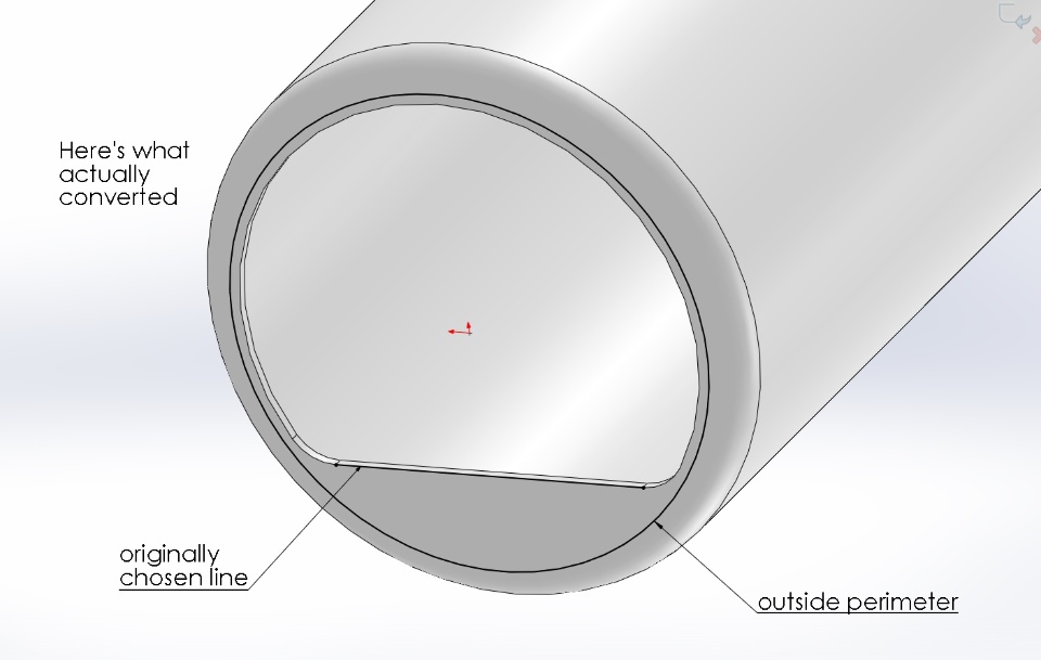

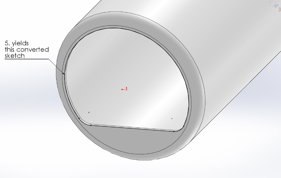

End result:
However, when I try to extrude:
It turns out that that edge I picked has converted, as well as the complete loop, so there's a duplication of geometry there.

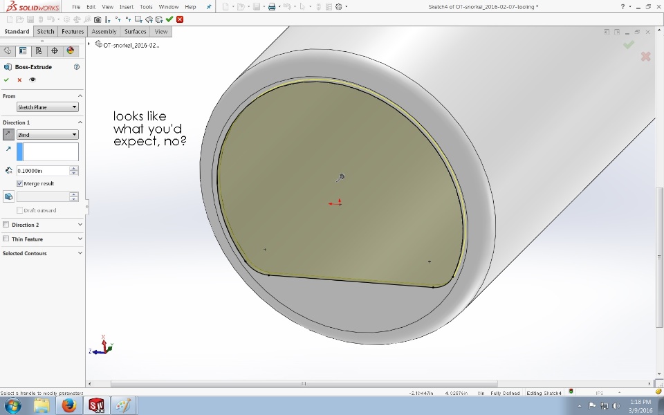

Nevertheless, this fails as well, because this is what remains when I exit the feature command
And so forth. The command isn't working like it used to.
