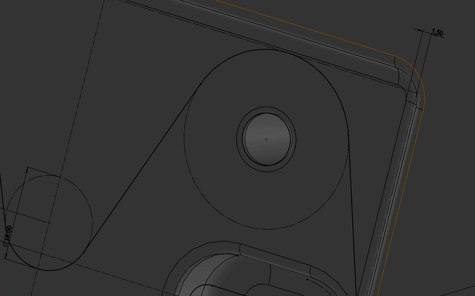

I'm creating a sketch for an Extruded-boss feature, with a hole already included in the sketch. This hole is made by Convert entities of another part, where I select the inside edge of a filleted shaft. Yet somehow, in finishing the feature, it takes the outside edge of the fillet.
The sketch on the bottom of the other part, with clearly the inside edge of the fillet converted.
Here the Extruded-boss completed: showing a bigger hole, exactly fitting the dimension of the outer edge of the fillet on the shaft of source part. The green sketch of the Boss also shows the discrepancy.
Anyone who knows what might be going on here?
Cheers, Frank

SD 2025-05-22 Best Answer
By default all contours (outer most) are selected when creating a boss.  In the boss extrude options there is a box toward the bottom where you can select which contours you want to extrude.  Take a look at those and see if anything is amiss.

Well that did indeed solve the problem with the end result, thank you Steven.
I'm still in the dark as to why SW included a contour that in no way was present in the sketch, curious if someone could elaborate. As this screenshot shows, it includes edges from the source part that didn't get Converted to entities:
